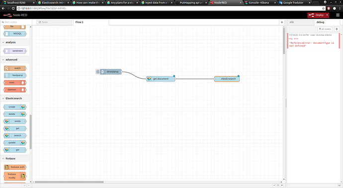

Sometime after some changes, I received this error:
"ReferenceError: documentType is not defined", and I been wondering, is it an error in Node-RED or ES? :confused:

Node-RED is beyond my scope, so please bear with me as I attempt humble troubleshooting. FYI, the pictures are really hard to see unforunately. I'm glad to hear things are up and running now and you have connectivity! I've found this flow, which may be the very one you are using, if not it might be worth a quick look. Based on the error it sounds like you're not defining the document type. Referencing that link I provided, it looks like regardless of the usage, create/delete/search/etc..., msg.documentType should be set in an incoming message unless it was configured in the node.
