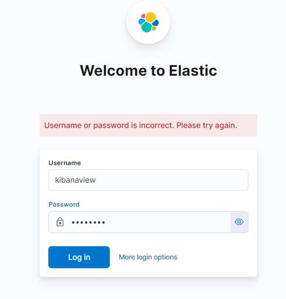

Hi Team,
I am not able to login to elastic even after typing the correct username and password.
Screenshot of the user details :
In the above image, role is "viewer".
We are able to login to those users whose role is "superadmin" only.
Previously the normal users were also working fine but from few days we are not able to login.
It is showing this error:
Please help us to resolve this. Thank You.
