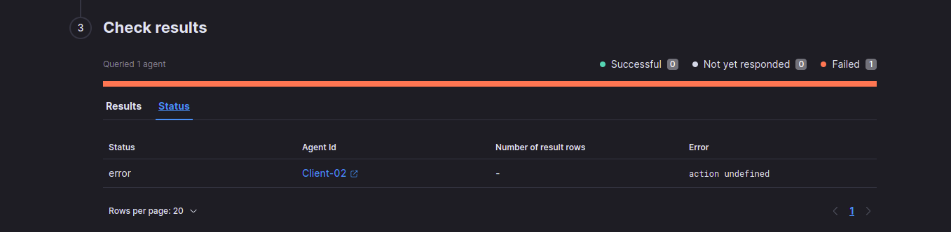

Hello,
I installed Osquery manager integration on my endpoints, for linux it worked like magic, while on the windows I get the following results
With no errors reported on log files (elastic-agent, osquerybeat, osquery ...).
I note the following:
  • osqueryd is running.
  • queries are perfectly executed on the endpoint using osqueryi.
  • I keep getting Non-Zero Mertics messages on osquerybeat.
Is there any required configuration to use osquery ?
how does osquery manager read results from endpoint ?
can you guide me to troubleshoot this problem ?
Thank You
