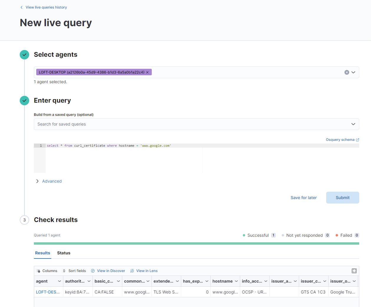

Running a query from the curl table returns an empty result. I've confirmed that other queries work and curl_certificates work as well.
SELECT * FROM curl WHERE url = 'https://www.google.com'
Is there any additional configuration that needs to be enabled for the curl table to work on OSQuery Manager?
Version Info: Elasticstack 8.2, OSQuery Manager 1.2.1
Broken curl:
Working curl_certificate:

Hi Aleksandr,
Thank you for the prompt reply and I believe your diagnosis is correct for HTTPS websites. However, I'm also seeing the save issue for HTTP websites that do not require any TLS certificate configuration. See screenshot below:
