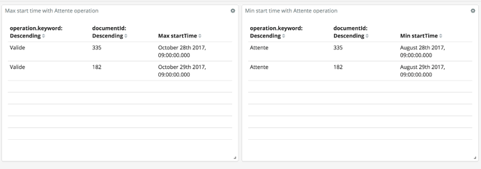

I think you can do this using two different visualizations and using a Min or a Max value on the startTime.
Would something like this work for you?
My final visualizations on a dashboard:

Thanks a lot ! It worked ! :slight_smile:
