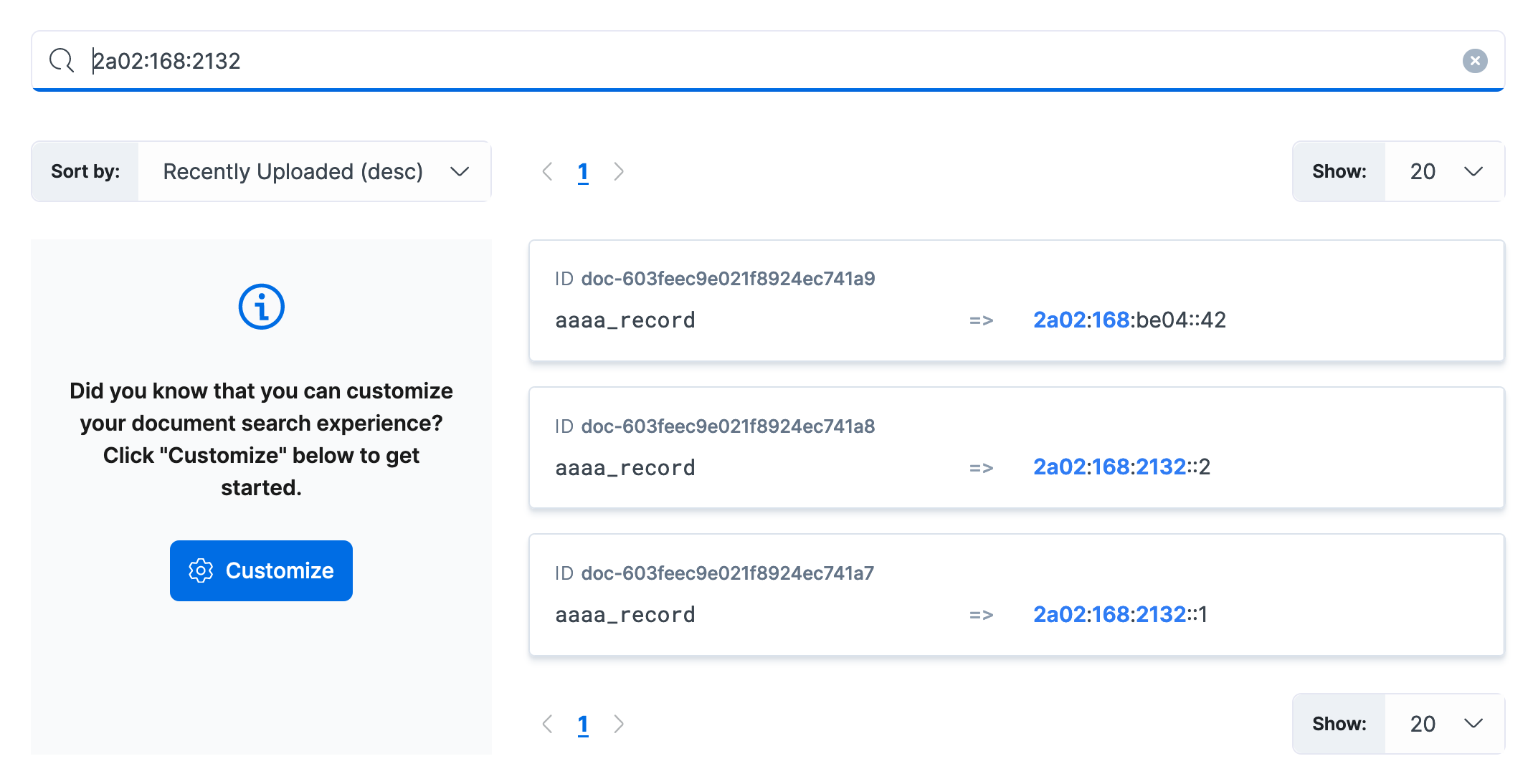

I'm running AppSearch for a research product. I store some IPv6 addresses in it: like
    2a02:168:2132::1
    2a02:168:2132::2
    2a02:168:be04::42
Now the problem is. If I try to search for 2a02:168:2132 it returns 2a02:168:be04::42too. Any idea? I know it's based on the prefix/... analyser which Elasticsearch uses by default. But is there something I could tweak in my query?

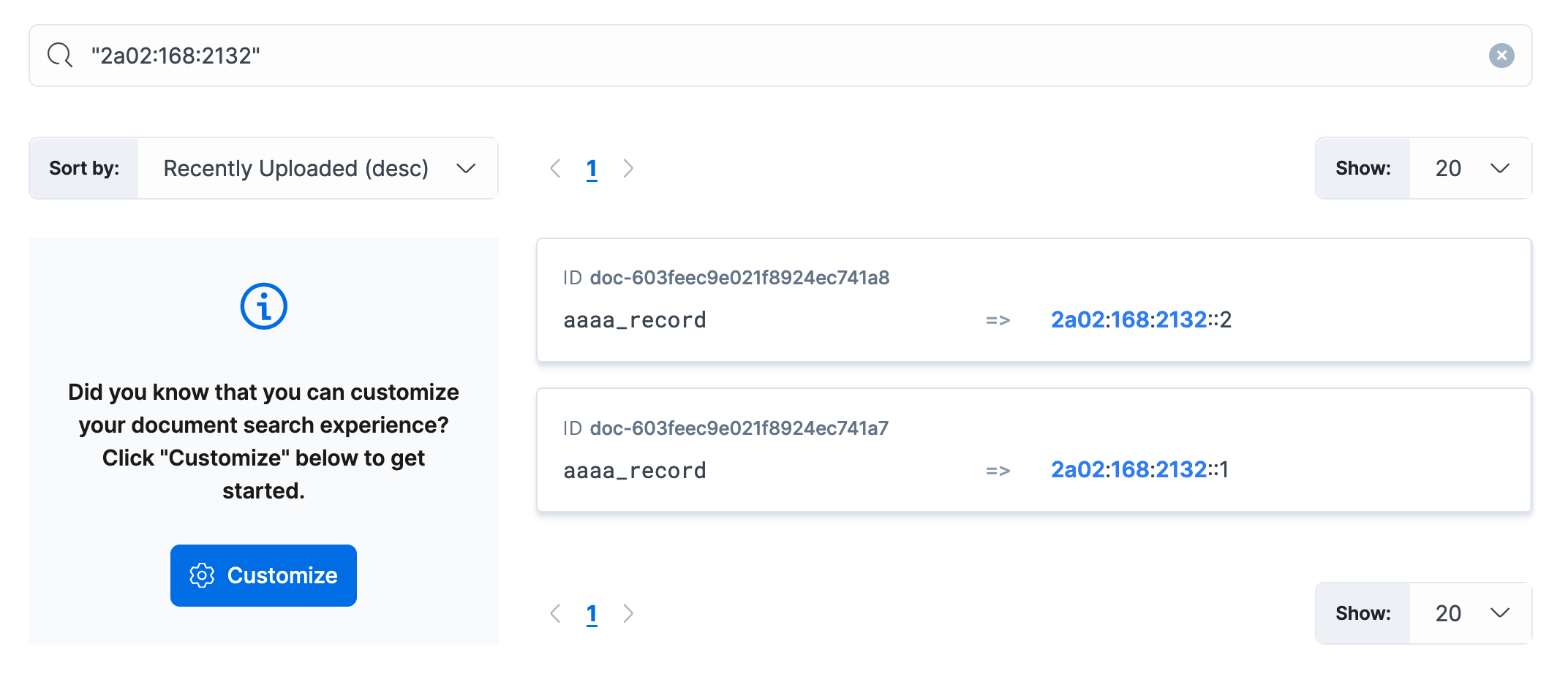

Hey hey! You should be able to wrap the "2a02:168:2132" query with quotes (so leaving out the .* regex).
Before:
After:
Hope that helps! Also for what it's worth, if you're not seeing what I'm seeing, my screenshots are from latest 7.11 Enterprise Search.
