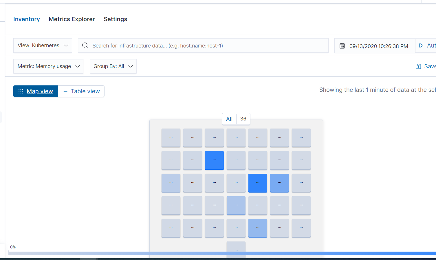

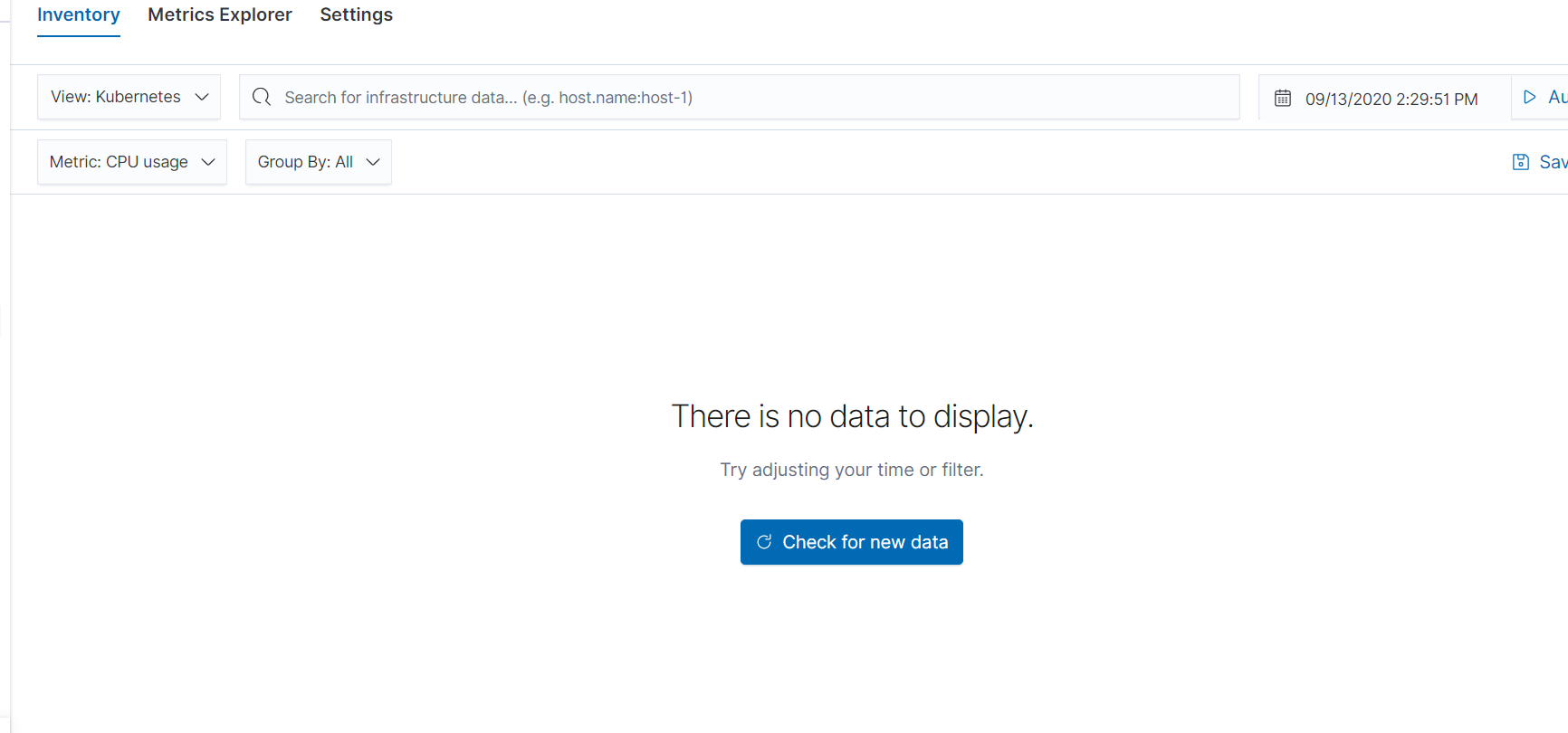

In kibana dashboard I can see only metrics of the hosts (cluster nodes) but not metrics of kubernetes resources (Nodes, Pods, Containers, Volumes).
Metrics Hosts:
Metrics Kubernetes:
