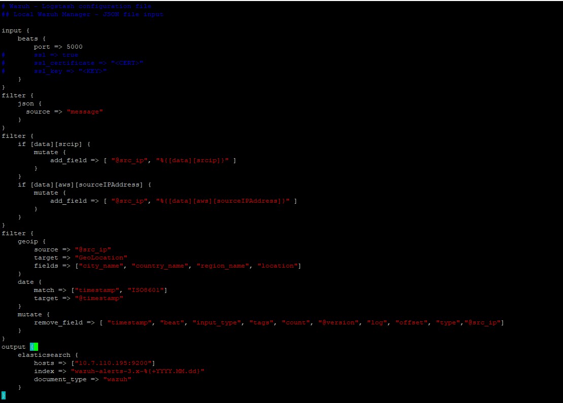

Logstash conf file
input {
beats {
port => 5000
ssl => true
ssl_certificate => ""
ssl_key => ""
filter {
json {
source => "message"
filter {
if [data][srcip] {
mutate {
add_field => [ "@src_ip", "%{[data][srcip]}" ]
if [data][aws][sourceIPAddress] {
mutate {
add_field => [ "@src_ip", "%{[data][aws][sourceIPAddress]}" ]
if "MSEC" in [message] {
mutate {
gsub => [ "message", ","MSEC":.{3},", ","]
filter {
geoip {
source => "@src_ip"
target => "GeoLocation"
fields => ["city_name", "country_name", "region_name", "location"]
date {
match => ["timestamp", "ISO8601"]
target => "@timestamp"
mutate {
remove_field =>[ "timestamp", "beat", "input_type", "tags", "count", "@version", "log", "offset", "type","@src_ip"]
mutate {
   rename => {"host" => "[host][name]"}
output {
elasticsearch {
hosts => ["10.7.110.195:9200"]
index => "wazuh-alerts-3.x-%{+YYYY.MM.dd}"
document_type => "wazuh"
