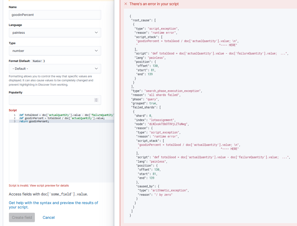

I made changes and am sending printscreen of an error. It seems that systems sees the totalGood as 0 for some reason.
Thank you...sorry for not replying right away but max reply limit was reached yesterday...
Hey, if at least one document in your index doesnt have value for the actual quantity or is 0 then it will fail. You can make a check and do the division if the value exists and is not 0

It seems like the error gets thrown before it even executes the script?

Yes, the failure seems to be a division by zero, according to that last error message.
Can you, just for testing, add a 1 to the second value?
Or just print out the bare values and see if it is zero.
Or try to divide it by a constant, like 2.

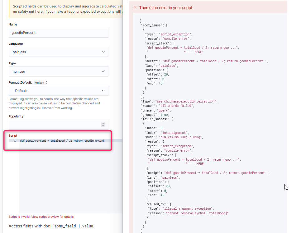

is this what you meant?
..if yes...then the error is that it cannot find totalGood...
Yes. That is very odd, since returning TotalGood in your first example was working, correct?

Yes, totalGood script works w/o any problems.
@Valerija this one fails because you removed the definition of the totalGood. If you add this line again in your script then it wont fail.
About the check to see if there is null or zero it should be a simple if statement.
Something like
def totalGood = doc['actualQuantity'].value - doc['failureQuantity'].value;
if (doc['actualQuantity'].value != null || doc['actualQuantity'].value != 0) {
   return totalGood / doc['actualQuantity'].value;
} else {
    // return what makes sense here if the doc['actualQuantity'] does not exist
    return totalGood;
My script might have typos, please ensure that I have the fields names correctly
