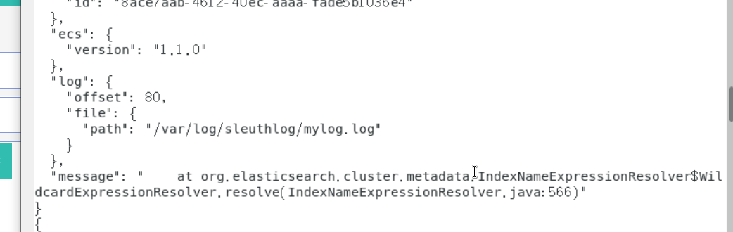

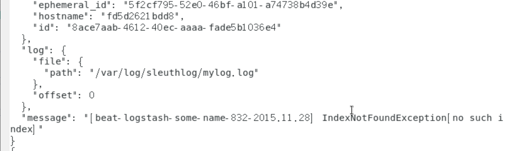

Obviously, the console printed logs are not merged:
