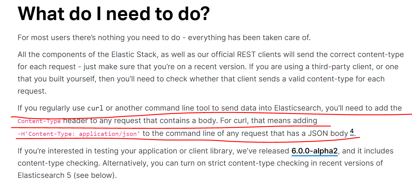

I have retrieved the similar issue and find that in elasticsearch 6.0 or high version there is a "Strict Content-Type Checking for Elasticsearch REST Requests"
You can refer to this URL to find the detailed report:
In this report, we can see we need do this action to adapt our pattern script
I have followed its indication then add the Content-type by curl command, but it still failed:

Now my major question is how can I do to add a header " -H 'Content-Type: application/json' " successfully?
