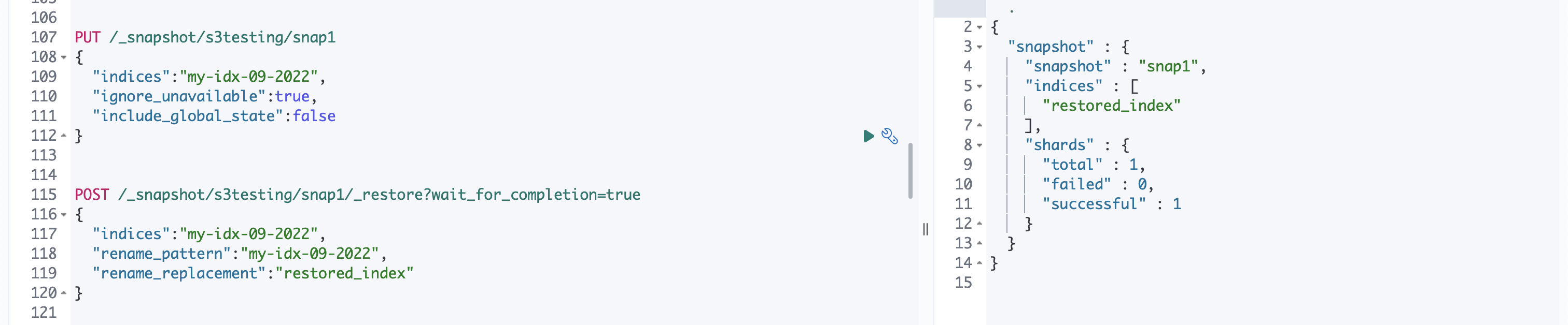

  1. Snapshot and restore my-idx-09-2022 to cluster2 index restored_index
Query
PUT /_snapshot/s3testing/snap1
  "indices":"my-idx-09-2022",
  "ignore_unavailable":true,
  "include_global_state":false
POST /_snapshot/s3testing/snap1/_restore?wait_for_completion=true
  "rename_pattern":"my-idx-09-2022",
  "rename_replacement":"restored_index"

Output:
  "accepted" : true
    "snapshot": {
        "snapshot": "snap1",
        "indices": [
            "restored_index"
        "shards": {
            "total": 1,
            "failed": 0,
            "successful": 1

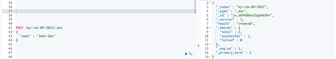

  1. Adding more document to my-idx-09-2022 but due to ingest pipeline the writes will go to my-idx-new-09-2022.
Query:
POST my-idx-09-2022/_doc
  "name" : "John Doe"
Output:
  "_index" : "my-idx-new-09-2023",
  "_type" : "_doc",
  "_id" : "8LEcPIkBgCbkoQPXQwh3",
  "_version" : 1,
  "result" : "created",
  "_shards" : {
    "total" : 2,
    "successful" : 1,
    "failed" : 0
  "_seq_no" : 0,
  "_primary_term" : 1
