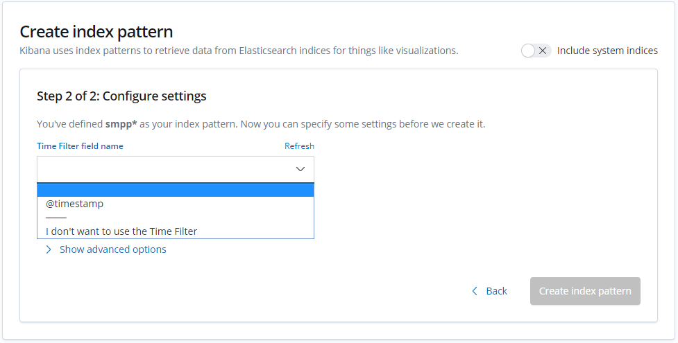

Here is my patern when i creat on kibana
it's don't have any field i creat !

i don't think is done because when i add timestamp field it doesn't show the log's time.
You can see this pic on Time Field an @Timestamp field i want replace log's time on that . Can you help me please

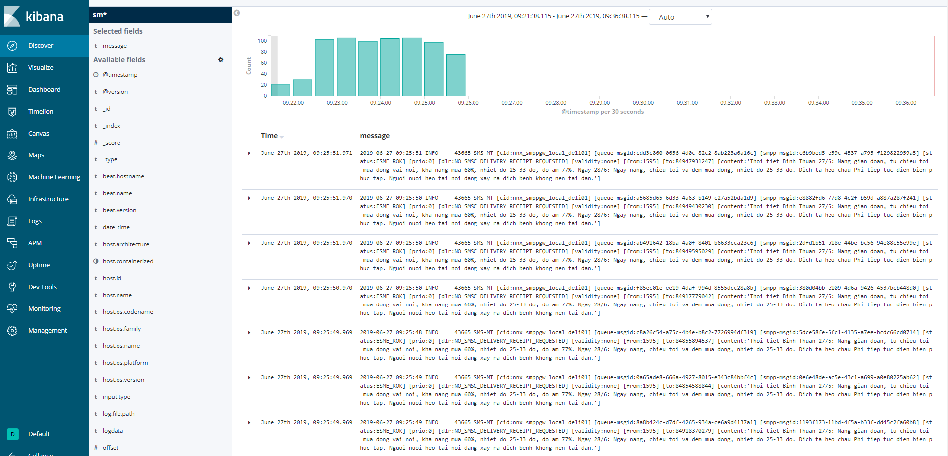

Well, in your discover view it shows the @timestamp field's value as "June 27th 2019, 16:06:15:271", which is the same as the timestamp in the log message (2019-06-27 16:06:15) - just in a different format.
So do you want the date to be formatted differently? This can be done in the Kibana settings.
Or did you want the message field to not contain the timestamp anymore? If so you could try displaying your logdata field instead of the message field.
