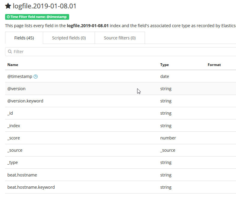

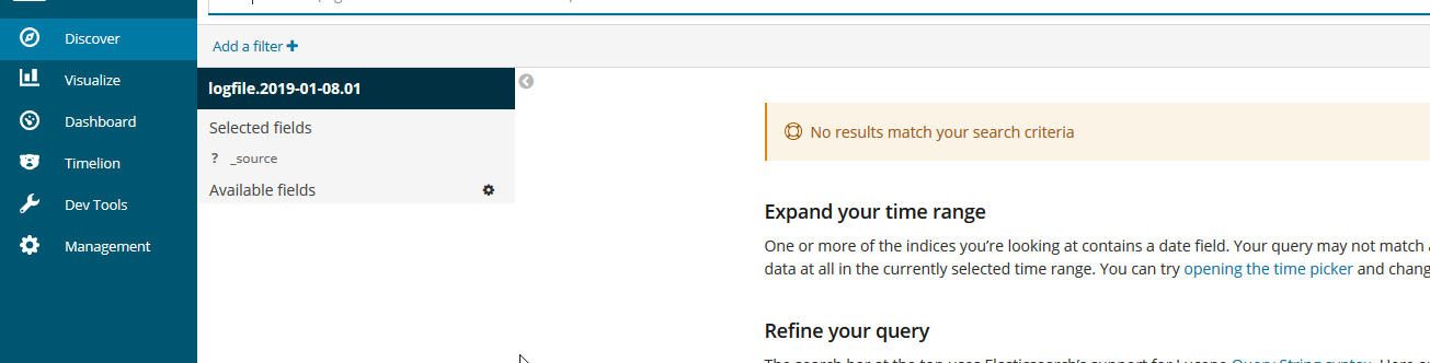

My problem is that when I try to create an index pattern for this file and try to use the "time filter" in Kibana there are no results shown in "Dicover".
If I don't use the "time filter" there are entries in the "Discover" tab.
As this problem only occured after changing the @timestamp value through logstash I thought this was fitting in the logstash category here.
Examples:
  1. Create new index pattern with time filter
  2. Create index pattern without time filter
    2019-02-01%2019_28_42-Kibana
    2019-02-01%2019_28_49-Kibana
Thanks!
Ah, now I understand, sorry... this is more of a Kibana question I suppose. With the time filter in place, make sure the time range you have selected in the Discover section actually includes data in the index. In your included images, I can't see what yours was set to. Here's a snip that shows what I'm talking about, in the upper right corner of the page:
In that case, you would only see documents with a @timestamp value that was within the past hour.
Okay, changing the date range was the issue, thank you very much!
