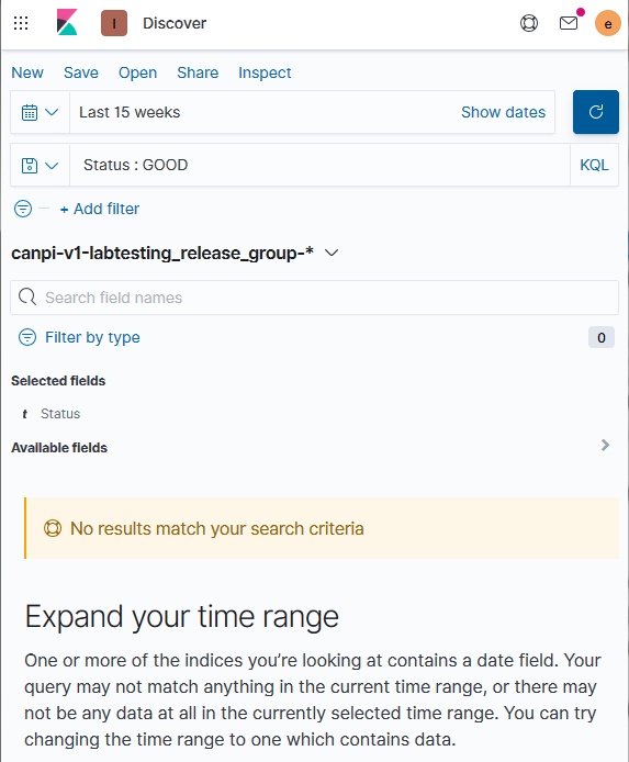

BUT I do get an unexpected "No results match your search criteria", which makes me feel that i have a type mismatch occurring on the return data.
Any Suggestions on strategies for resolving / diagnosing output of scripted fields?
Hmm, can you try removing the space before "GOOD"?
No Change / Difference
But if I remove/disable the filter, here is what i get
