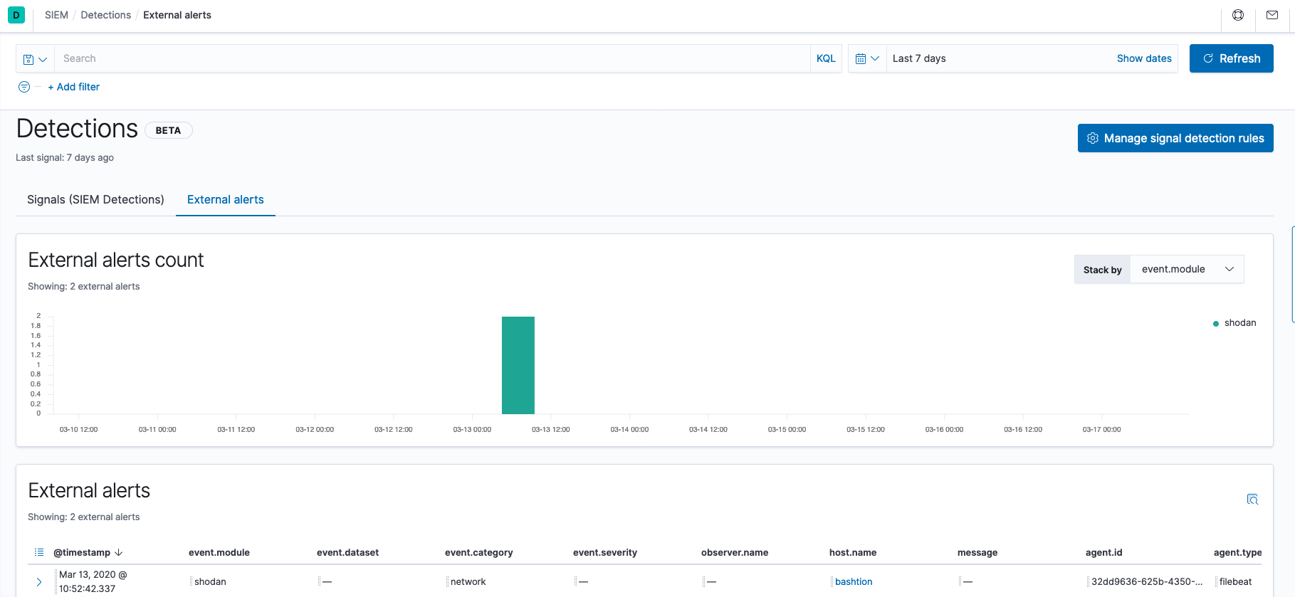

Ok I've figured out a crude implementation, in summary :
shodan stream --alert=all --compresslevel 0 --datadir=/local
filebeat.inputs:
- type: log
paths:
- "/local/*"
json.add_error_key: true
fields_under_root: true
fields:
event:
type: "change"
kind: "alert"
module: "shodan"
category: "network"
TODO
Here is the result :
Hi hilt86,
Woa, that is really cool! You should put what you have on a github project and make it into a python package for people to collaborate on?
With just what you have above, you should be able to create signals from it at this point. But enriching the data by transforming what makes sense into ECS will make it even more useful.
