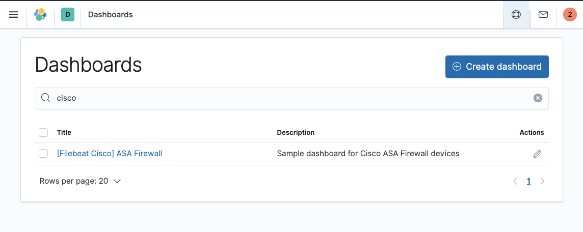

In addition to the SIEM/Security app Network page widgets, the filebeat modules also install one or more Kibana Dashboards into Kibana when the filebeat setup command is first run. For example the NetFlow module provides these.
and the filebeat Cisco module also installs a dashboard:
Can you confirm whether your dashboards and the SIEM/Security app Network page widgets are being populated with your events?
