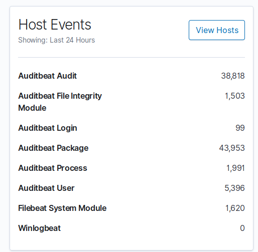

Started playing with SIEM after upgrading our Stack and some agents to 7.2. I currently have winlogbeat and auditbeat sending data to our stack. Auditbeat has the host and process modules enabled, winlogbeat is sending Application, Security, and System logs. The Overview page shows the following:
However, going into the Hosts section, most of the tables are empty.

The error message means it cannot write the host information to disk to persist between restarts, but it should still send host events containing IPs and MACs to Elasticsearch. Can you confirm that you have no documents with event.dataset: host in your data?
On authentications, this is collected by the Login dataset, and from your screenshot of the Host Events widget it looks like you have login events?
Hi @cwurm, finally I deleted auditbeat elastic index and kibana index pattern and I re-setup autidbeat ('auditbeat setup') . After that, SIEM Authentication, IPs and MACs work ! :slight_smile: .
