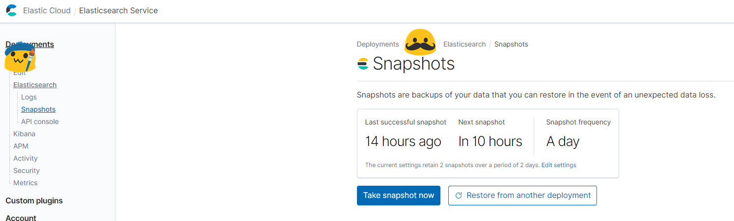

Are you able to list existing snapshots in the Elastic Cloud UI?
If you're not able to list existing snapshots, then open a support case at https://cloud.elastic.co/help
If instead you are able to list the snapshots, then this is what you can do:
  1. Create the new IO optimized deployment
  2. When creating it, select the option Select a deployment to restore from one of its snapshots:
  3. You will be able to restore the snapshots sharing the same repository of the old deployment.

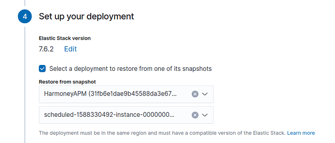

I can see the snapshots of my current deployment:
When I create a new deployment, I can select the snapshots:

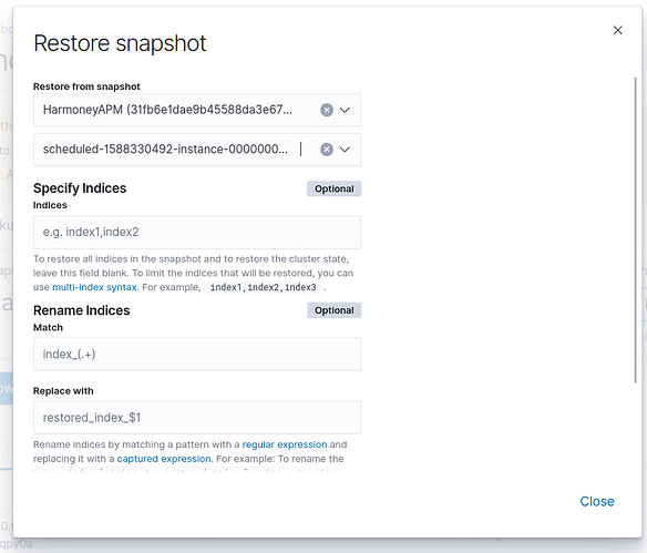

When I create a new blank deployment, I can select a snapshot:
So that all works as expected, but the execution of the snapshot restore fails with the stacktrace that I mentioned.
