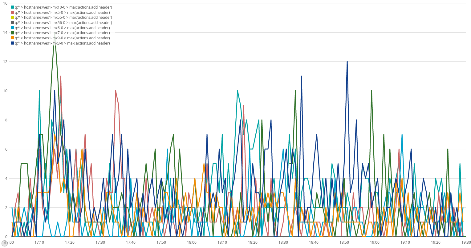

I have partial success.
.es(index=spam-status-*, timefield=date, metric="max:actions.add header",split=hostname:20).derivative()
returns this graph
But when I use cusum() function, it not makes sense what I get for me.
.es(index=spam-status-*, timefield=date, metric="max:actions.add header",split=hostname:20).derivative().cusum()
I expected the sum of all derivative series.
