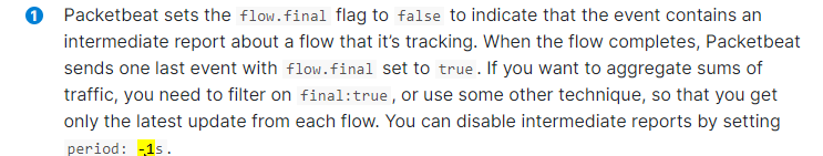

@Mike_Paquette Thanks for the explanation. I will try your suggestion. It seems that the documentation indeed mentions this:
So maybe the SIEM datatable containing Bytes In / Bytes Out could be tuned so it only lists the sum of traffic where flow.final equals true? That way we can still use intermediate flow reports without having this weird side effect in SIEM.
Grtz
Willem
Setting period to -1 works. So what about:
Thanks for the reminder @willemdh. Yes, I'll create an issue for tuning the queries associated with the Source IP and Destination IP tables in the Hosts views as you suggest. We should base this on ECS fields, of course :slight_smile:
