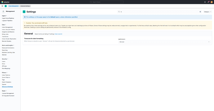

Management -> Kibana -> Advanced Settings -> Type tz in the search box if you want to find it quickly. Maybe that helps?
Hi Mario,
Thanks for your answer.
But this doesn’t help, my settings are default, so this one has already ‘browser’.
Herman
