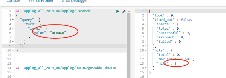

The id query will trigger refresh, but I still can't search with query qsl?
official documentation : the get API will issue a refresh call in-place to make the document visible.
id query doc

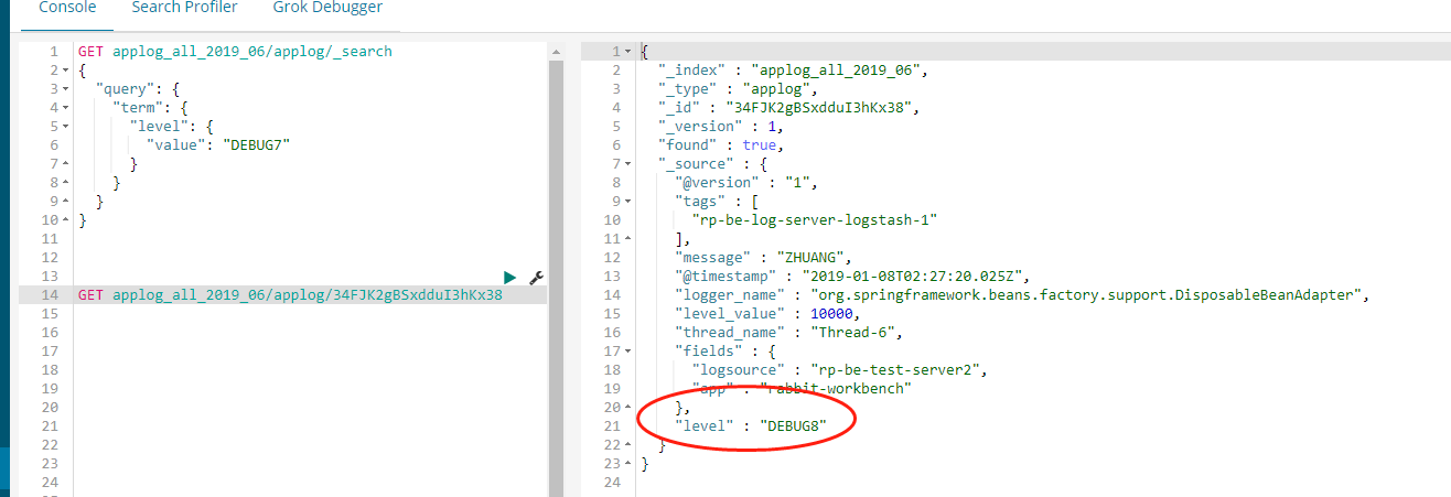

First I call the id query, then call query QSL, the official documentation says it will call refresh, but I still can't search with query qsl?
(I set the refresh_interval is 60s for test)
It will only call a refresh if the document has been updated.
As shown in the figure,I first add a document, and then call the id query to find this data, but I still can't query with the query QSL, so querying a new document will not refresh?

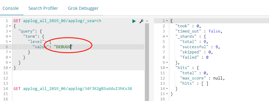

Wǒ chángshì qù gēngxīn yītiáo wéndàng, gēngxīn level cóng DEBUG8 biàn chéng DEBUG9, ránhòu shǐyòng id cháxún kěyǐ zhǎodào zhǎodào zhè tiáo wéndàng, dànshì wǒ shǐyòng query DSL yòng DEBUG9 qù cháxún zhe réngrán zhǎo bù dào zhè tiáo wéndàng.
87/5000
I tried to update a document, update the level from DEBUG8 to DEBUG9, and then use the id query to find this document, but I still can't find this document using the query DSL.
So does the id query not trigger refresh?
