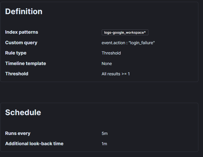

I am trying to create a Threshold rule-based .. if I have 1 or more events with login failure, create an alert, As you can see in the image, in the Rule preview, some alerts were "found", but this rule is not generating any alert...
Is someone can try to explain to me why in the rule preview, the "rule" works, but it is not generating an alert?

The short answer for why rule preview shows alerts while your rule has not produced them is that rule preview does not time travel: it shows you the result of N simulated rule runs over a particular period of time (36 hours in your screenshot) with all your current data. Unless your data is static from the time of rule creation, the actual rule executions will differ from rule preview because all of the data is present for rule preview, but only some of that data was present during the actual rule execution.
Ingestion pipeline delay, or late-arriving events in general, is a big source of false negatives, and why we recommend using e.g. event.ingested over @timestamp. I suspect this is what you're seeing in your environment. When coupled with rule preview, it can appear as though a rule missed an alert.
You can confirm this by increasing the lookback of your rule (which for a threshold rule isn't quite the same thing as running a "shorter" execution in the past, but should be sufficient for validation) far enough that you meet your alert threshold.

Yes, for now, my look-back is 1 minute and my rule is run every 10 minutes
I will try to put the same time that my rule runs, 10 minutes, I am not sure If I understood you correctly.
A simple timeline of what I'm hypothesizing might help:
  1. At time 0 (T0), a "login failure" event is generated at the data source, and is sent to elasticsearch with an @timestamp of 0 (I'm using integer times for simplicity).
  2. At T11, the rule executes, and looks back over the @timestamp range [T0, T11].
  3. No alert is generated, because no events are found
  4. The ingest processor finishes processing the T0 event above, and it's now available (but this doesn't matter to the rule, because next time it runs it will be looking at the @timestamp range [T10, T21]).
You can see in the above example that running Rule Preview after step 4 would show an alert being generated, because the T0 event is now there, even though the rule never caught it.
You might also observe that there are two solutions to this problem:
  1. Increase you're rule's lookback so that it captures the T0 event
    • this is an imperfect solution because you're effectively setting the "maximum ingest lag" this way, and you're not guaranteed to catch all late-arriving events
  2. Configure the rule to search based on ingest time (event.ingested) instead of observed time (@timestamp).
    • This is the more robust solution, since it guarantees that events will not be missed. It does, however, require you modifying your ingest pipeline to add this field (if it does not already).
I hope that helps!

I tried to change the configuration of the rule for event.ingested, but my rule is
still not able to create an alert, I am not sure if I configured it correctly, I am sharing with you my rule configuration
@luizmeireles the recommendation for your situation is to use event.ingested as the timestamp override field, which is an advanced rule setting (instructions linked). It should not be needed for any other part of the rule configuration (e.g. the "Threshold Count" setting can/should go back to using event.action, if desired).
If your data does not have event.ingested populated, you'll need to add an ingest pipeline yourself; the first example linked here shows how that might look.
