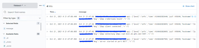

Tomcat logs are seeing appearing in order in discover section in kibana
Thanks
You mean this flag button?
Hi @leandrojmp,
Made the changes as above and can see logs are appearing in order. (commented pipeline.workers : 1)
