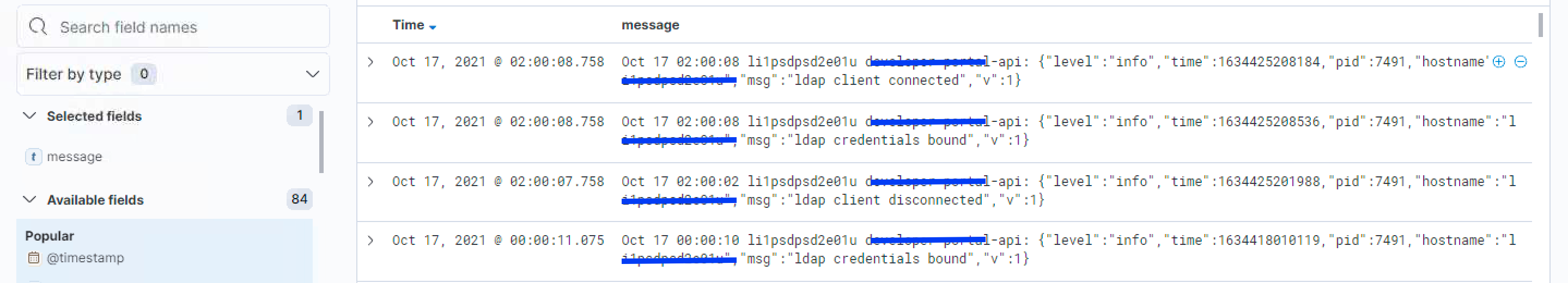

From server, i can see below last logs on App1 server,
On kibana, the last line is different and not same as above server logs. ( I have filtered with tomcat logs and selected App1 server only)
If i try to search last line of server log (i.e consentStatus: accept) in kibana (did ctrl+F to search on page), i found it somewhere in middle and not at the first line (i.e as latest)
Similarly, if i try to search another log line (i.e subject: 1000000....) which is last 4th line in server log but at kibana it is not last 4th line.
Sorry for all the screen shots and highlighted mark.
Why it's not appearing in sequence and how can we fix this?
