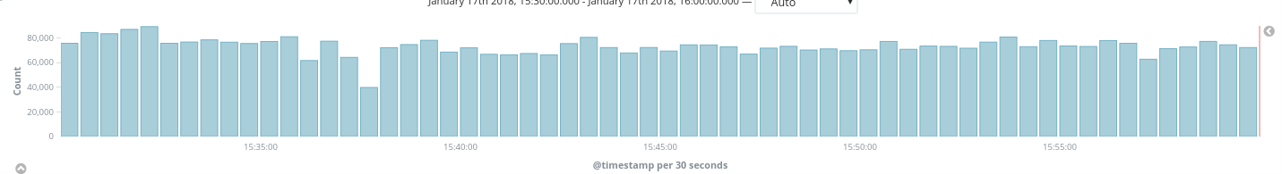

Then I have the following scenario in the monitoring page.
My index data will have gaps
It should normally looks like this:
The only service running in this node is the elasticsearch.
