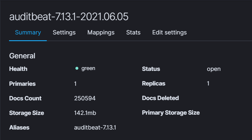

For these indices I could see that there was no aliases.
Hence I created an aliases using:
POST /_aliases
  "actions" : [
    { "add" : { "index" : "auditbeat-7.13.0-*", "alias" : "auditbeat-7.13.0" }
However on indexes where Aliases is present, I get the error: (secondary error)
illegal_argument_exception: rollover target [auditbeat-7.13.1] does not point to a write index

I can see following logs in /var/log/syslog
(status=400): {"type":"illegal_argument_exception","reason":"no write index is defined for alias [auditbeat-7.13.1]. The write index may be explicitly disabled using is_write_index=false or the alias points to multiple indices without one being designated as a write index"}
I have tried adding parameter is_write_index : true but that hasn't solved the problem.
