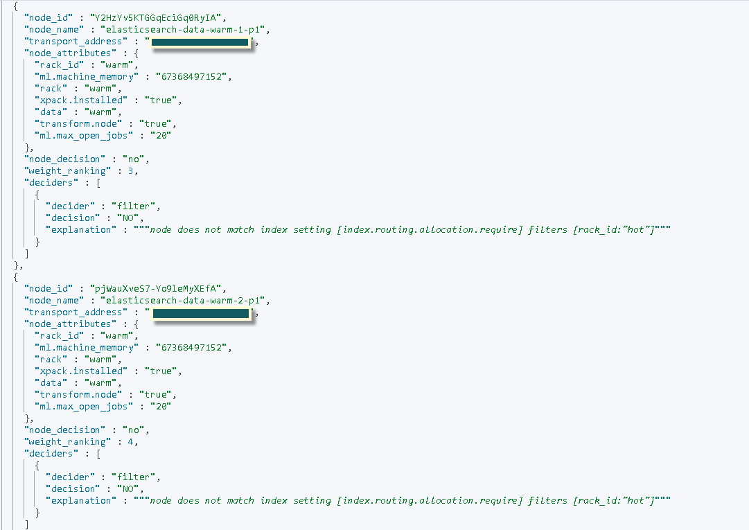

This is the result 1-20-2021 9-03-56 AM
What does https://www.elastic.co/guide/en/elasticsearch/reference/current/cluster-allocation-explain.html show?
Sorry but i can only upload images since copy/paste is disabled between my computer and the server.
EDITED: I may need to remove some of the attr in the yml file and experiment with the filtering.
Ok, i finally figured it out. It was the awareness that was causing the trouble and "maybe" the other attributes.
On the master nodes elasticsearch.yml, i removed "routing.allocation.awareness.attributes".
On the data nodes (hot/warm/cold), i only retained "node.attr.data"
On the index templates, i changed it to "index.routing.allocation.require.data: hot"
