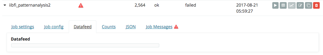

Hi,
I want to delete a failed job.
A pop-up appears and an error is displayed.
36 pm
The stopping and deleting datafeed fails because the datafeed was already deleted when I tried to delete it the job the first time.
I recently started using Kibana and can't figure out how to delete it even after reading through topics in the forum. Please help me solve this.

Hi Rich,
The datafeed was stopped and deleted successfully when I tried to delete the job. Only the jobs won't delete.
