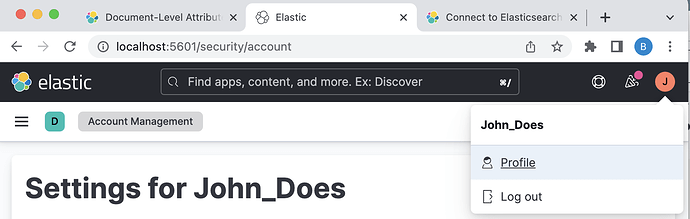

  1. Login to the Kibana UI using the newly created username john and password john@123.

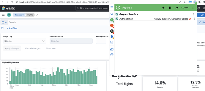

  1. Now, logout from the Kibana-UI. Use the above token to access the dashboard.
    You can see that I am using a chrome extension to inject the header. I am able to happily access the dashboard.

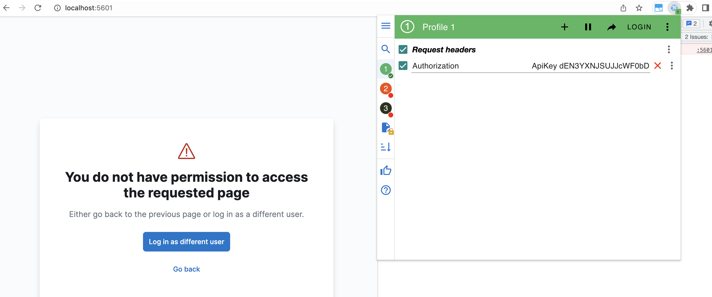

  1. Now try to access the dashboard again using this new token test-api-key-2 similar to step-7.
It is returning 403: forbidden.
Q-4: How did the token lost its Kibana access priviledge?
NOTE: Even if I remove the query section completely from payload, still it does not work with Kibana.
This is because you did not specify the above application privileges (kibana privileges) for the key. Therefore the key did not have permission to access kibana. In this case, an API key does not automatically inherit its owning user's permission.
Thank you so much, @Yang_Wang. This is exactly what I was looking for.
I assumed that the api_key will inherit the values from role if not specified in the API_Token payload. Understood now that we need to exclusively specify the application priviledges there.
