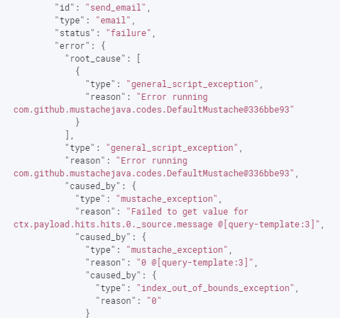

I want to print out the error message from my logs into my mail. However, its giving me this error.
Below is the alert jason code i am using:
Can you please help. I am new in elastic search and am trying to print out the error message from the logs.
Please refrain from using screenshots, but share via code snippets. Thanks!
The shown output is not enough to verify. Is it possible that you set size: 0 in your query and thus no hits are returned?
Please share the whole JSON from the execute watch API or the watch history otherwise. Thanks!
