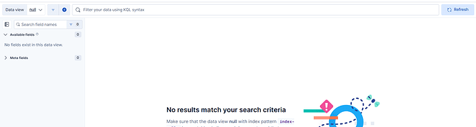

But below is the WA which can be used if you want to keep it as null =>
Create a null index (PUT /index_null)
Create a dataview null => index_null
Make this dataview as default
Now while loading Discover it will use this dataview :
Thanks!!

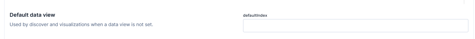

Hi @mittal_rawal,
The default data view can be unassigned by resetting `defaultIndex` configuration on Advanced Settings page.
Thank you @jughosta
Can you please confirm if it will load nothing?
Checked on ELK Version : 9.0.2
I tried below & see that it still loads the Default Set Dataview :
Logged Out & Logged In after this change / Even Restarted Platform =>
It loads the Default DateView even though setting is Null/Blank in Advanced Settings :
Thanks!!
