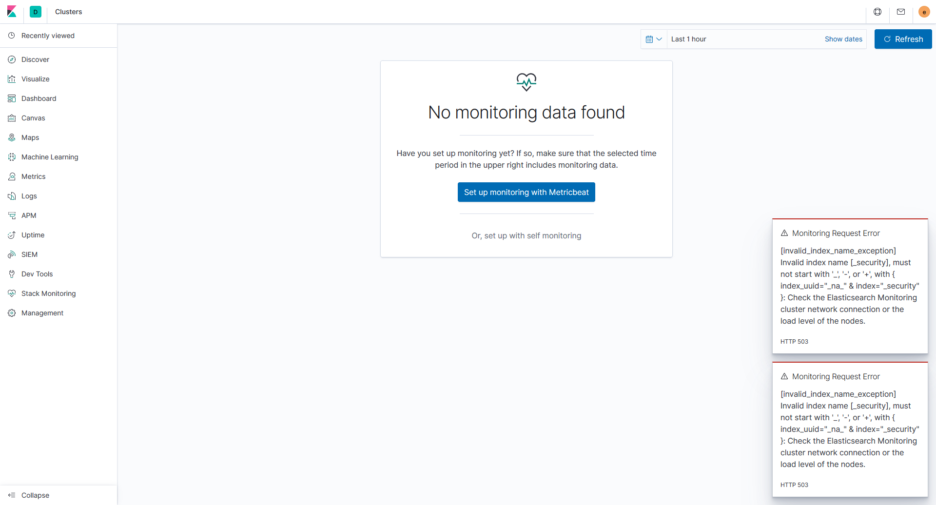

Are you sure that we are talking about the same issue here? I'm not talking about "how to setup Stack Monitoring", it's about that Stack Monitoring is not working if xpack.security.enabled is set to true on the monitoring node.
Here are two screenshots...
1.) xpack.security.enabled = true on Monitoring Node
2.) xpack.security.enabled = false on Monitoring Node
