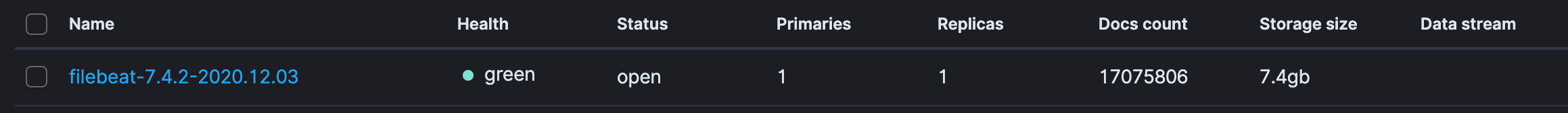

Hello all. A maddening problem. We upgraded our cluster to 7.10 (ES, Logstash, Metricbeat, Auditbeat, Filebeat). Since we use Logstash I manually loaded each index template for the beats and default dashboards, then I removed the old index templates for earlier versions, and closed the indices for the old ones.
When we start logstash it tries to write to the old beat index! Here is our output below, along with the error we see in Logstash. Anyone have a hint on how to fix this?
Not writing to new 7.10 index. Trying to use old one!
[2020-12-02T11:48:05,438][WARN ][logstash.outputs.elasticsearch][main][a95592bf084961207f2e0f22aae7a98b42d2e6b6aee1995c6a0b944fffefabb6] Could not index event to Elasticsearch. {:status=>400, :action=>["index", {:_id=>nil, :_index=>"auditbeat-7.4.0-2020.11.06", :routing=>nil, :_type=>"_doc"}, #<LogStash::Event:0x5c0b1e5c>], :response=>{"index"=>{"_index"=>"auditbeat-7.4.0-2020.11.06", "_type"=>"_doc", "_id"=>nil, "status"=>400, "error"=>{"type"=>"index_closed_exception", "reason"=>"closed", "index_uuid"=>"gaWjJRBERhSifVG82Hu9qg", "index"=>"auditbeat-7.4.0-2020.11.06"}}}}
In our output we set a dynamic index to write the correct beat index...from this it should write a new 7.10 index correct? But it doesn't. It goes to the old one. I checked the individual servers and it has the correct 7.10 beat version on it.

When looking at the records coming in we see this:
_index:"filebeat-7.4.2-2020.12.02"
but with setting our index in Logstash to dynamically pick up new 7.10 beats:
index => "%{[@metadata][beat]}-%{[@metadata][version]}-%{+YYYY.MM.dd}"
it should be:
_index :filebeat-7.10.0-2020.12.02
But it's not!

As. you can see when I loaded the template manually (by disconnecting Logstash, and then using curl injected the new 10.7 template into ES and restarted...but Logstash/Beat just keeps on making old index names. The Logstash config is set up to dynamically name the beat by beat-version-time as is normal.
It's also showing ILM errors, and I turned off lifecyle management to try and troubleshoot. Here is the exception.
