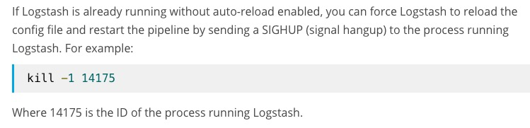

Using kill -1 pid to force logstash to reload the configuration file does not take effect
I use the following method to make the logstash reload configuration file, but did not take effect, what is the reason?
My logstash version: 5.1.1
The method comes from https://www.elastic.co/guide/en/logstash/current/reloading-config.html#_how_automatic_config_reloading_works
