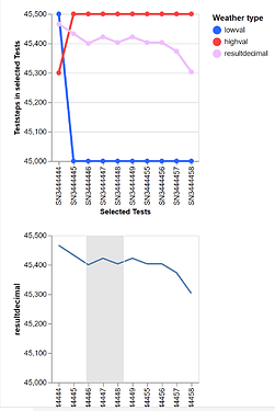

Hi,
I am trying to create an interactive vega graph which is zoomable. I have the brush and everything but it doesn't zoom in on the other graph.
I oriented myself on this.

The problem is that the selection doesn't do anything:
Hope someone can help me on this.
Kinda works now:
