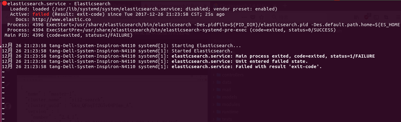

What can I do for this error
I have already installed elasticsearch-2.4.4.But is cant be start. Who can help me?Thanks
Can you show the content of your elasticsearch.log file?
I have checked the log file.it's empty!
Which log file did you check? In /var/log/elasticsearch?
Yes, this file is empty.But now I have already solved it. I used apt-get to install elasticsearch.It also install some others libs.Then i removed elasticsearch but not remove the libs.At last I installed the deb‘s package .It can be worked.
