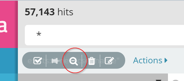

Does every document in this index have a value for both of those fields? You could use the Discover tab to check by using the * icon on those fields;
and then negate that exists filter by clicking the magnifying glass with the - in it;
If there are docs where either of those fields don't have a value, you'll have to use a little bit more complex script fir the scripted field. I can try to find a good example of that if you find that's the case.
