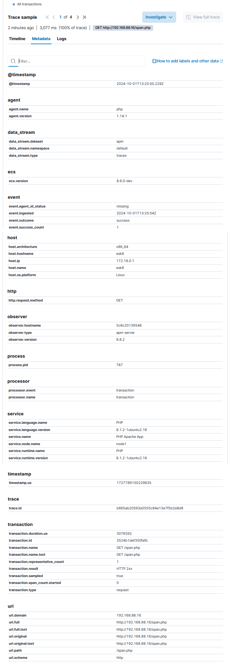

Thanks, I clicked as you suggsted but don't see the word spangled_banner anywhere.
here's what i see so far under the transactions>timeline>GET /span.php
If I click on GET /span.php or if I click on Metadata and I see this:
Let me know where else I should look? Or maybe my PHP code is wrong and I haven't transmitted the span information yet?
The reason for this issue might be the fact that the transaction is begun but not ended.
There is actually no need to start a transaction since there's always a default transaction that is automatically started (Public API | APM PHP Agent Reference [1.x] | Elastic) and ended by Elastic APM PHP agent itself.
So one way to fix it:
<?php
use Elastic\Apm\ElasticApm;
$transaction = ElasticApm::getCurrentTransaction();
$span = $transaction->beginCurrentSpan(
    'spangled_banner',
    'span_type',
    'span_sub-type', // optional
    'span_action' // optional
try {
    // do your thing ...
    echo 'start sleep';
    sleep(3);
    echo 'done sleeping';
} finally {
    $span->end();
