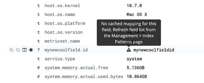

Hi @EricJohnson
How did you add the field? Like this?
https://www.elastic.co/guide/en/beats/metricbeat/current/add-fields.html#add-fields
If you look at your server.id field in discover does it look like this?

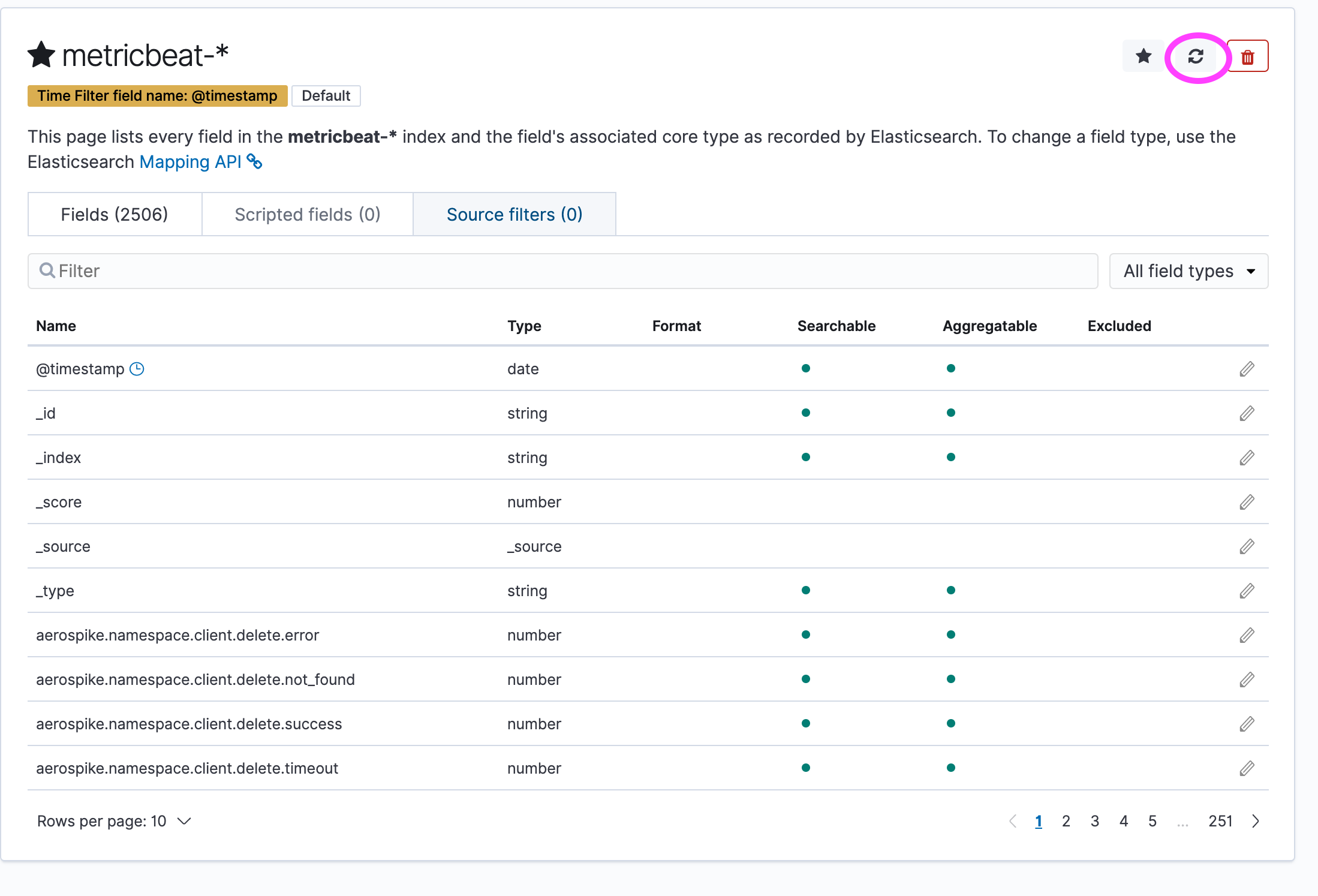

You probably need to go refresh the index pattern.... have you done that?
After you do that you should be able to see something like this...
It may take a few minutes to show up in Discover
