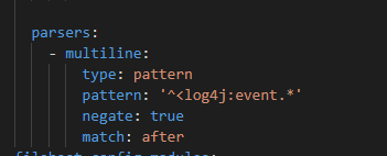

I am sending error and fatal logs, these have multiple lines, so the multiline is configured like this:
filebeat multiline:

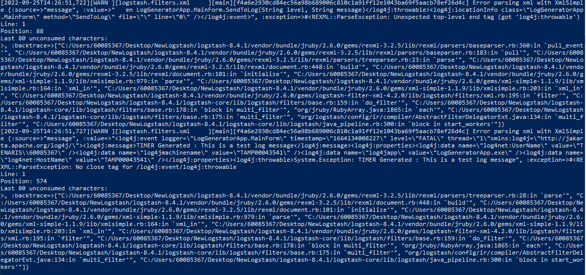

This is throwing me an error:

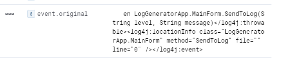

and in kibana I can see that the log sends it like this:
part 1:
par2:
Note in the image that the first line and the second are sent separately.
This happens to me when I send two fatal or two errors or a fatal and an error from different apps.
If I only send from one, I have no problems.

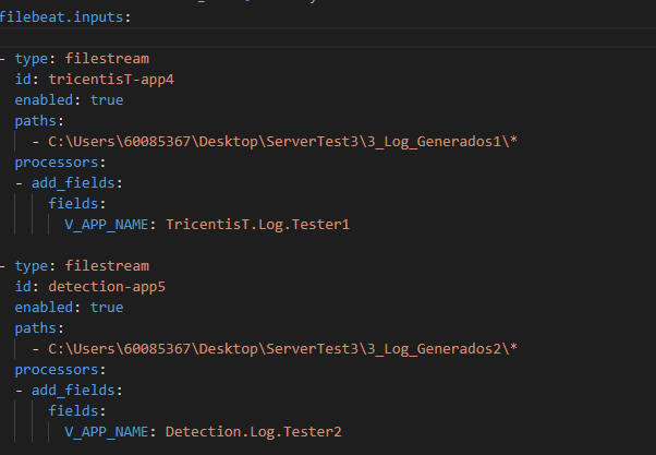

Resolved. At first I was configuring a multiline for all inputs so I tried assigning a multiline for each input just like the processors and it corrected the error.
filebeat.inputs:
- type: filestream
  enabled: true
  paths:
    - C:\Users\60085367\Desktop\ServerTest3\3_Log_Generados1\*
  processors:
  - add_fields:
      fields:
        V_APP_NAME: TricentisT.Log.Tester1
  parsers:
    - multiline:
        type: pattern
        pattern: '^<log4j:event.*'
        negate: true
        match: after
- type: filestream
  enabled: true
  paths:
    - C:\Users\60085367\Desktop\ServerTest3\3_Log_Generados2\*
  processors:
  - add_fields:
      fields:
        V_APP_NAME: Detection.Log.Tester2
  parsers:
    - multiline:
        type: pattern
        negate: true
        match: after
