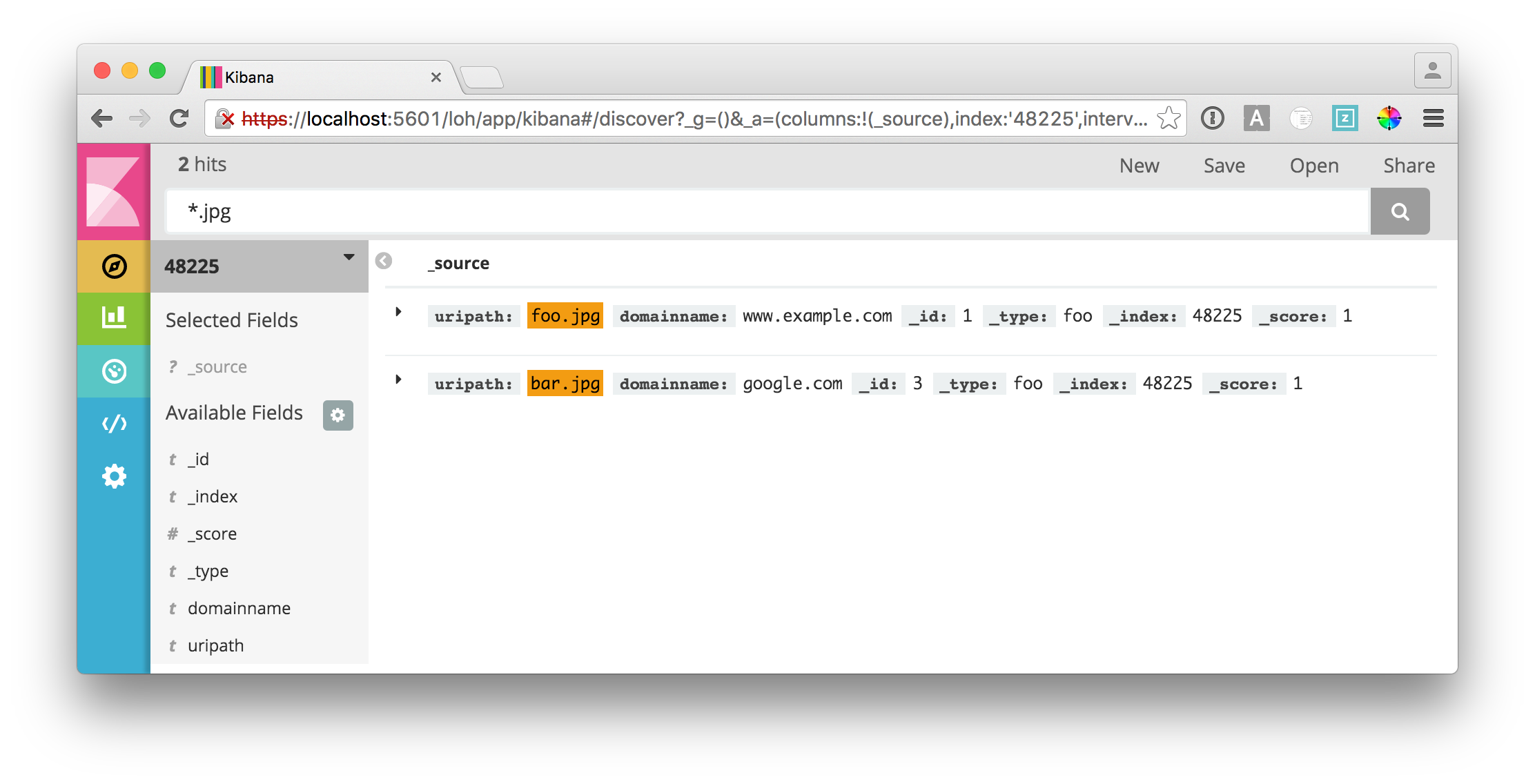

In Kibana, When i type "*.jpg", its return the values.

Yes, jpg files are present in my logs. Since When I simply type in search bar on kibana "*.jpg", it shows the values.

I have tested this and it appears to be functioning correctly.
