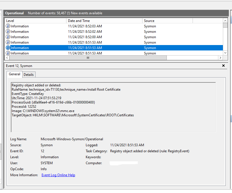

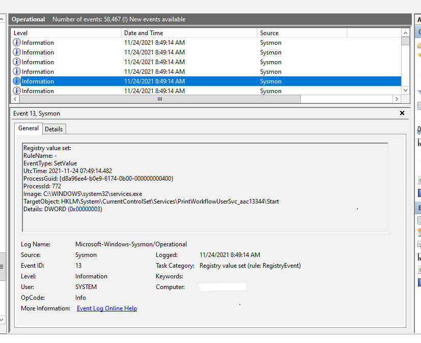

Is it only Sysmon events that are affected? Do you get Security log events that contain message?
It is only with Sysmon event Windows Security, System and Application event work fine and send the message field

Can you take a screen shot of one of these Sysmon events inside the Windows Event Viewer? I'm curious if you have a message there.
Hoi Andrew Kroh,
Is there an update?
