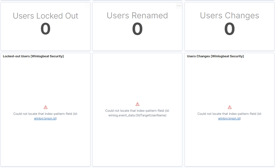

After inspecting the dashboards I noticed the following thing.
I have checked the index template mapping and I do not have any mappings for this field.
I have met with this error a lot of times during the last few months.
I did not change the configuration regarding the index template, index pattern in beats .yml
I have not idea what I am doing wrong so my mapping set up from beasts have missing fields.

But the fields did not dynamically add. I just want to understand If the error in dashboards results from fields that are no longer used or it's something else?
This is even weirder. It's like It's present but it's not?
I don't get It.

I did some extra test with a clean environment and here the explanation: when you first executewinlogbeat setup --index-management a winlogbeat index is created based on winlogbeat's index template. In that index pattern there is no definition for winlog.logon.id nor winlog.event_data.OldTargetUserName. That's why when you enter the first time to the dashboards the error appears.
Once you have real data containing values for winlog.logon.id and winlog.event_data.OldTargetUserName and you refresh the Kibana's index pattern the error will disappear.
Just to check, just rename a user in windows, so event 4781 is generated, refresh your index pattern and
should disappear.

I asked my friend to add a local user and change his name. The output shows some field but even after refreshing the index pattern this is the dashboard look.
Please close the browser and open the dashboard again.
Regards
Yes, now I can see everything. Thank you very much for your help in resolving this as well as helping me understanding how It works :slight_smile: <3
