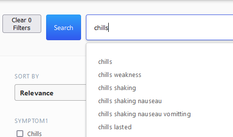

The autocomplete input loses focus after each letter is typed..
My goal is provide the searchTerm and filters objects to the export button. Thanks in advance.
All rightee then! I'm answering my own question, but hopefully will help others - writing this out acts as my own sounding board.
You need to utilize the HeadlessCore, which provides withSearch. Here's the reference documentation.
So the component itself will be responsible for pulling what it needs from the React context. Just import withSearch to your component, and export the function as shown in the example:

export default withSearch(({ filters, clearFilters }) => ({
  filters,
  clearFilters
}))(ClearFilters);
Autocomplete input field retains focus. Problem solved :vulcan_salute: :vulcan_salute: :vulcan_salute:
