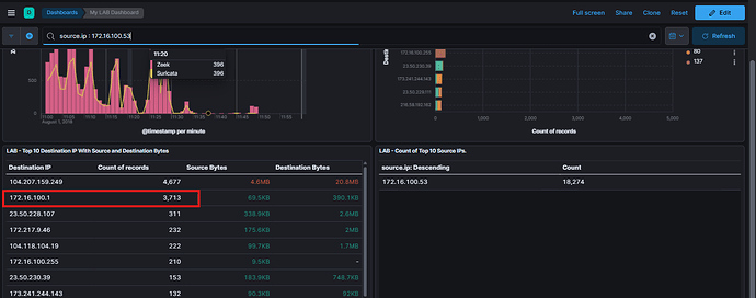

Navigate to the My LAB Dashboard and set the time range to the entire day of Aug 1 (Day 0). How many connections were made between 172.16.100.1 and 172.16.100.53?

Post creating the “My Lab Dashboard” as per the steps provided we need to filter using below query for the question :
for the source.ip : 172.16.100.53 , we see the destination ip in the left table & the count is 3713

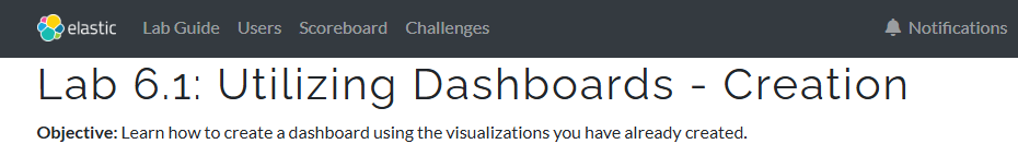

Hello I tried to do that but my problem was I couldn’t find the dashboard named “my lab dashboard “ so I was never able to get the answer I made sure to search the name as well as do control f
Hello @Mayad_Koujah
Okay, the "My Lab" dashboard is not available by default.
We need to follow the steps as per the below Lab Guide & it will help us to create this dashboard.
Access the CTFd URL
Click on Lab Guide
In this as part of 6.1 you will see this step :
So you need to follow the Lab Guide, complete the instructions and then move to Challenges.
But before this need to complete previous lab instructions in 4 & 5.
Thanks!!
