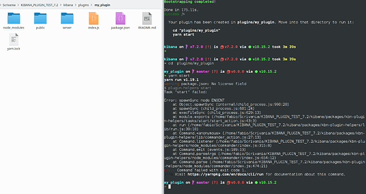

Problem is that now if I go to plugins/my_sample_plugin and run yarn start it immediately returns the error:
yarn run v1.19.1
warning package.json: No license field
$ plugin-helpers start
Task "start" failed:
Error: spawnSync node ENOENT
    at Object.spawnSync (internal/child_process.js:990:20)
    at spawnSync (child_process.js:601:24)
    at execFileSync (child_process.js:629:13)
    at module.exports (/home/fabio/Scrivania/kibana_7.2_test_plugin/kibana/packages/kbn-plugin-helpers/tasks/start/start_action.js:43:3)
    at run (/home/fabio/Scrivania/kibana_7.2_test_plugin/kibana/packages/kbn-plugin-helpers/lib/run.js:30:10)
    at Command.<anonymous> (/home/fabio/Scrivania/kibana_7.2_test_plugin/kibana/packages/kbn-plugin-helpers/lib/commander_action.js:27:13)
    at Command.listener (/home/fabio/Scrivania/kibana_7.2_test_plugin/kibana/packages/kbn-plugin-helpers/node_modules/commander/index.js:315:8)
    at Command.emit (events.js:189:13)
    at Command.parseArgs (/home/fabio/Scrivania/kibana_7.2_test_plugin/kibana/packages/kbn-plugin-helpers/node_modules/commander/index.js:654:12)
    at Command.parse (/home/fabio/Scrivania/kibana_7.2_test_plugin/kibana/packages/kbn-plugin-helpers/node_modules/commander/index.js:474:21)
error Command failed with exit code 1.
info Visit https://yarnpkg.com/en/docs/cli/run for documentation about this command.

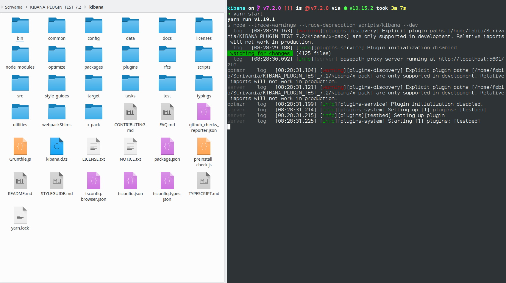

Yes, if I run yarn start from the kibana/ folder it runs. Now I'm about to replace the node_modules/ folder in the kibana/plugins/my_plugin/ folder with the one from kibana/ and see if it works.

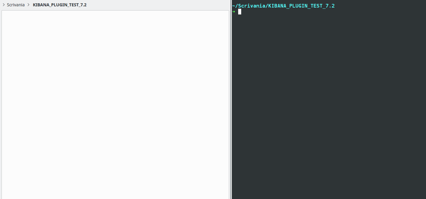

Here's the step-by-step procedure I followed:
  1. Create a folder KIBANA_PLUGIN_TEST_7.2 inside the Desktop and move there
  2. Cloning the kibana repo from github (git clone https://github.com/elastic/kibana.git)
  3. Cd into the cloned kibana repo (cd kibana) and check the git status (git st) to verify I'm on branch master
  4. Checking out to stable version 7.2.0 (git co tags/v7.2.0)
  5. Run yarn kbn bootstrap from inside the kibana/ folder (you can see the warnings while bootstrapping)
  6. Bootstrapping successfully completed and working yarn start from kibana/ folder
  7. Generate the my_plugin plugin (node scripts/generate_plugin.js my_plugin) with all the due choices
  8. See the usual warnings during the plugin generation
  9. Plugin successfully generated
  10. Move into plugins/my_plugin and run yarn start. Damn error is returned
I want to point out my node --version returns v10.15.2, so it should be ok.
Sorry for the length of the post but this way you can really follow me throughout all the steps.

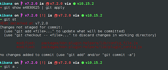

Ok I guess I found the problem with the help of a colleague of mine.
Reading the error there's a call to kbn-plugin-helpers/tasks/start/start_action.js.
Going back through all the linked files we noticed there's a line in packages/kbn-plugin-helpers/lib/plugin_config.js which refers to the old folder structure, calling the path ../../kibana as if the plugin was placed inside the old kibana-extra folder.
The error
`Error: The 'KIBANA_ROOT' environment variable has been removed from '@kbn/plugin- helpers'. During development your plugin must be located in '../kibana-extra/{pluginName}' relative to the Kibana directory to work with this package.`
should have rung a bell about it.
Then we went with git blame packages/kbn-plugin-helpers/lib/plugin_config.js from which you can see that Tiago Costa applied a fix to that path in commit e4830625.
Thus, running git show e4830625 | git apply from v7.2.0 branch, you can see that some files got modified
It'll then be sufficient to add the edits (git add .) and commit ignoring the linter (git commit -m "whatever" --no-verify).
Now, running the yarn kbn bootstrap, node scripts/generate_plugin.js my_plugin and cd plugins/my_plugin/, yarn start everything works as expected.
It's kinda strange that such an important fix is not mentioned anywhere (apart from git history) and I really do not understand how it could work on your environment.
You sure replicated my exact steps, cloning the repo, checking out to 7.2.0 and running everything else without changing anything? Since it really shouldn't work because of that wrong path.
Anyway, hope this thread will be of help to anybody who needs to develop a plugin for Kibana 7.2.x.
