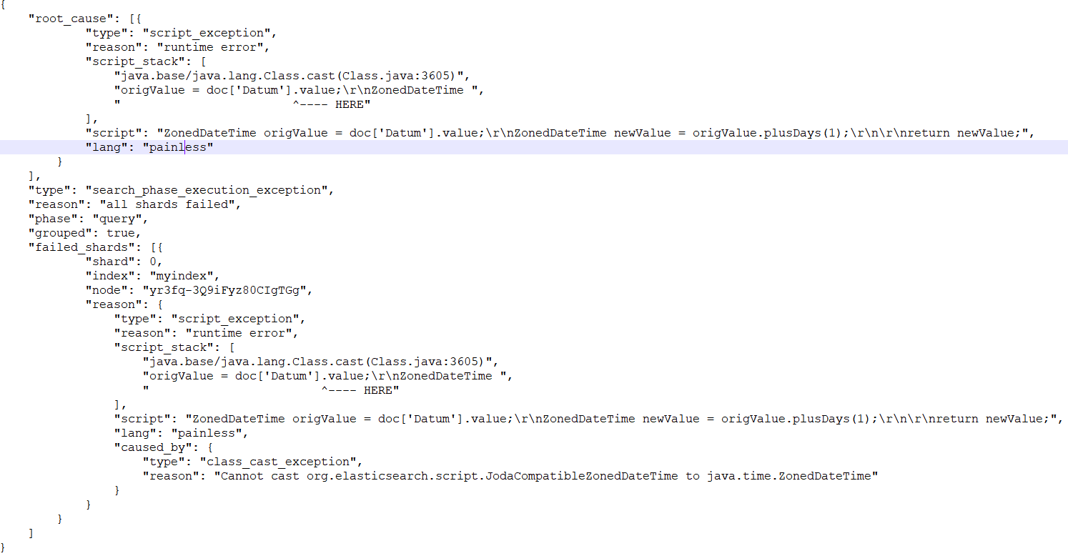

hm, not working
origValue and newValue ist not recognize by script language (or meant its not "blue")
if I change newValue to just new it change the color to blue
but what is the right param for origValue ?

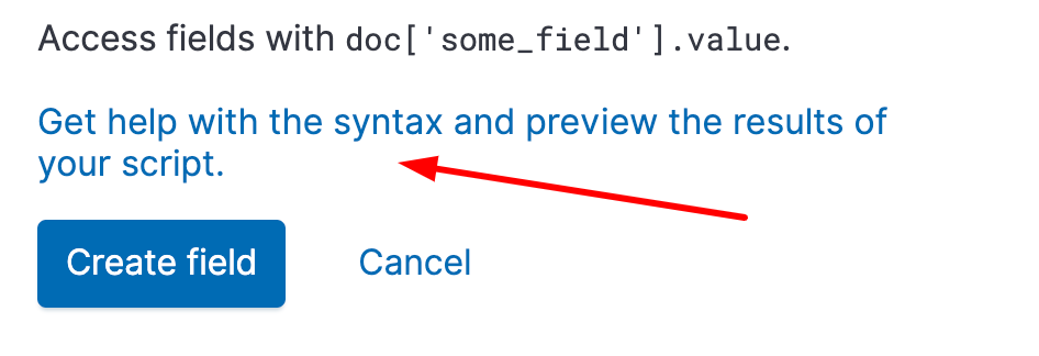

Here is what I have.
When clicking on Get help with the syntax and preview the results of your script. at the bottom this is what I am showing.
If there are errors in the script this is where they would show them. What does yours say?
Can you put in your query that generates this error also?
Also what does your Datum field look like? Can you paste an example.
You might need to use JodaCompatibleZonedDateTime vs ZonedDateTime according to that error.
