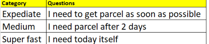

I have 2 fields in my system (1. Category & 2. Questions)
Here is my requirement goes. and below is my data.
My requirement. I need to Manually add one more new field called Sub category by writing elastic search query which is not there in the system. with the below criteria.
  1. If my question is "I need to get parcel as soon as possible" AND Category is "Expediate" Then it should be "Express" as subcategory
  2. If my question is "I need parcel after 2 days" AND Category is "Medium" Then it should be "MIDLEVEL" as subcategory
    1. If my question is "I need today itself " AND Category is "Super fast " Then it should be "HIGHER" as subcategory
Below should be my output
  1. Need Questions field aggregation
  2. Need New field as subcategory aggregation
Expected result : aggregate the data such that there's a new column which depends on the original Question

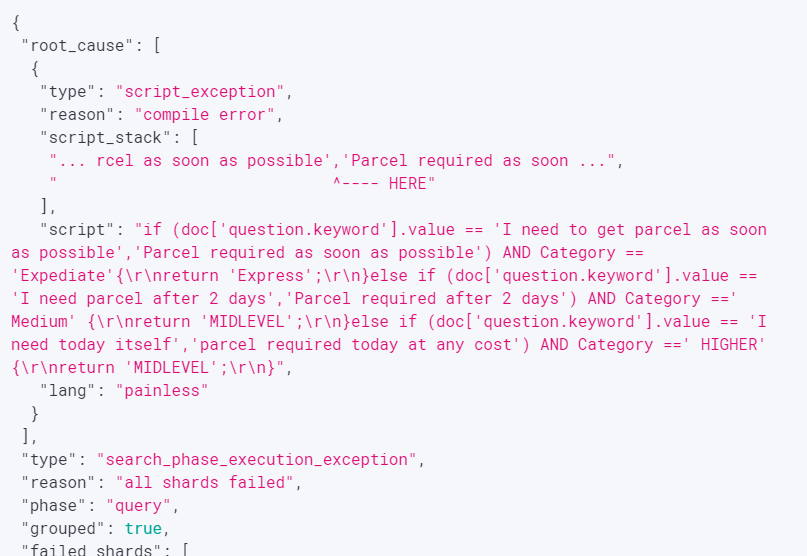

I Ran below statement:
if (doc['question.keyword'].value == 'I need to get parcel as soon as possible','Parcel required as soon as possible') AND Category == 'Expediate'{
return 'Express';
}else if (doc['question.keyword'].value == 'I need parcel after 2 days','Parcel required after 2 days') AND Category ==' Medium' {
return 'MIDLEVEL';
}else if (doc['question.keyword'].value == 'I need today itself','parcel required today at any cost') AND Category ==' HIGHER' {
return 'MIDLEVEL';
I am getting the following error. Do no how to write correct query format.
Your syntax is pretty off - if you have multiple conditions, list them like this:
if ((doc['question.keyword'].value == 'I need to get parcel as soon as possible' || doc['question.keyword'].value == 'Parcel required as soon as possible') && doc['category.keyword'].value == 'Expediate') { //...
